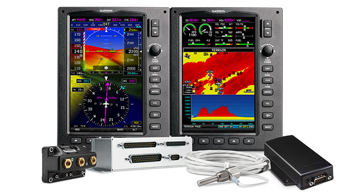

All the capabilities you want in a true “glass cockpit” are brought together in the G3X flight display system. Designed specifically for experimental/kitplane and light sport panels, this scalable system lets you grow as your needs and budget allow.
This easy-to-install suite can contain up to 3 redundant PFD/MFD configurable displays, all of which contain built-in GPS and big, bright, sunlight-readable 7" high-resolution WVGA screens. G3X provides full PFD attitude/directional guidance along with electronic engine gauges, terrain/obstacles alerting, georeferenced FliteCharts and SafeTaxi airport diagrams. ADS-B “In” with traffic and weather, ADS-B “Out” transponder and angle of attack sensor can all be added easily. An affordable Garmin autopilot system is also available with advanced features such as coupled approaches and auto-trim as well as flight director, indicated air speed hold and straight-and-level button when installed with an optional control panel.
You can choose a single- or multi-display configuration with separate PFD and MFD displays — or you can even add a third co-pilot’s display, if desired.
One System — Many Solutions
The integration and versatility provided by the G3X electronic flight displays make it easy to customize the ideal panel layout for your aircraft. You can start with a single display — or use as many as 3 displays — to fit the space, avionics stack and budget available. Here are just a few examples of what’s possible and practical in a G3X installation.
Single Display
The versatile G3X panel-mount glass displays work like building blocks, allowing you to grow your system to fit your needs and budget. You can start with a single display that combines full PFD attitude/directional guidance with electronic engine monitoring and moving map MFD capabilities.
Dual Display
Want a 2-screen flight deck layout with separate PFD and MFD displays? That’s an easy upgrade with G3X. You get a large-format attitude and heading display, paired with your moving map and engine gauge data. A built-in Garmin network interface allows for full reversionary capability on either screen.
Triple Display
The Garmin network interface allows for a maximum of 3 displays to be interlinked in your panel. You can use the third unit as an optional second MFD to display even more data at once — such as dedicated engine information and moving map.
